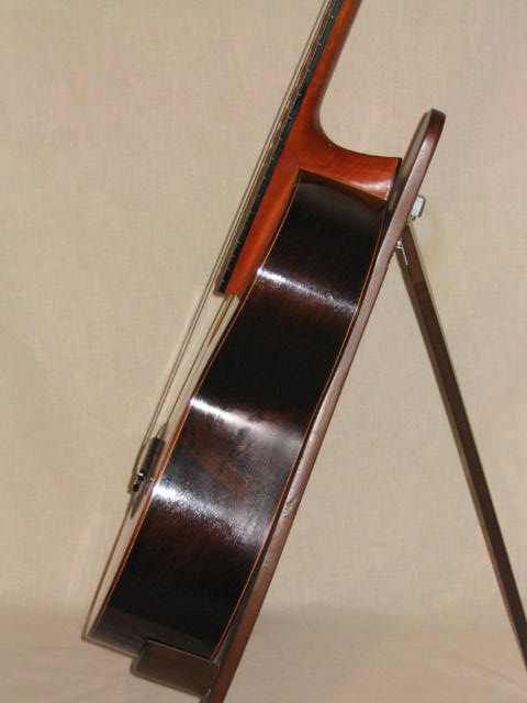

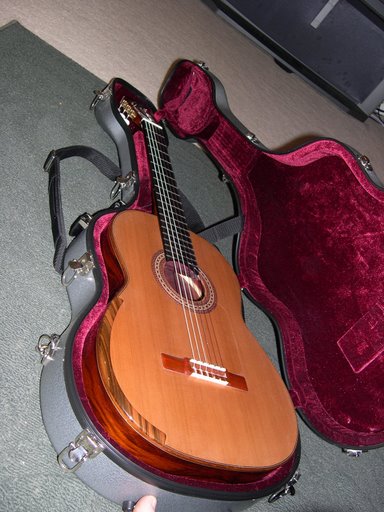

I just bought the best sounding classical guitar I've ever played, and it comes in just slightly over 7 lbs. It's a lattice braced guitar built in the style of the best Australian builders (aka Smallman) which means many laminations and a very thin top. As you can see from the pic, the back is arched like a cello helping with volume and projection. One of the coolest features is an adjustable allen screw at the 17th fret which allows adjustmnet of the neck angle. I've been playing with it all day and think it's one of the greatest innovations for classical guitar. I'll post more pics and sound clips when I get a chance.

John-
Looking forward to more pics and details!
Is that a padauk bridge?
And is the armrest let into the body, or suspended above it?
Thanks for the look!

Redgate John? Smallman uses padauk bridges. I must admit when I played a Smallman the weight did get too much for me, but I suppose it's only a matter of getting used to it.
Anyway, I love to see more detail and especially hear a sounclip.
PostPosted: Thu Nov 01, 2007 3:07 am
Looks beautiful...with all the "innovations" on it...does it have a spanish heel? I assume NOT since you said there was an adjustment screw at the 17th fret. Just wondering because I have been told over and over that classical players are mostly "purists" when it comes to their guitars and therefore would never consider a bolt on neck. I am currently building three classicals with bolt ons and wondering if it is going to come back to bite me. At any rate what do you attribute all the weight to if the top is very thin? I assume the back must have been rather thick at one point in order to get all that recurve into it.
WOW 7lbs + are you sure it's not a Les Paul?

I know of at least one renown classical luthier who glues on the neck with a splice, but when it is done, you cannot tell the difference in appearance between that and a one-piece Spanish style heel. Does that make any diffenece to anyone?

[QUOTE=Bill Bergman] I know of at least one renown classical luthier who glues on the neck with a splice, but when it is done, you cannot tell the difference in appearance between that and a one-piece Spanish style heel. Does that make any difference to anyone?[/QUOTE]
I noticed in my copy of Courtnall that the Fleta example had a dovetail joint in a small neck block, so he seemed to get away without using the 'Spanish' heel.

The plywood frame inside, the laminated sides, and the thick carved back all contribute to the weight.  At least its not hanging from a shoulder strap!
This adjustable neck is essentially a re-orientation of what Stauffer was doing back in the 1800's.  They've moved the adjustment screw from the heel to the fingerboard, and have adjusted the construction to make it look more like the traditional Spanish heel.  Stauffer used an elevated fingerboard to allow for the movement, the Australian school use a slot under the fingerboard.  I believe that Smallman, and others, would all acknowledge this design lineage.
Apparently, a lot of guitarists think that using an elevated fingerboard on a contemporary classical guitar is very cutting edge.  Go figure...

I should have mentioned, yes, it is a guitar built by David Schramm. I sent back a Jim Redgate and David Daily guitar before I received the Schramm which I knew was a keeper as soon as I played it. The link Marc posted above shows a look at the inside and why they are so heavy. Basically, the back and sides are as sturdy as possible so the thin top is providing all the sound. Sitting on the lap in normal classical position is very comfortable and the weight is not an issue at all. As a matter of fact, it feels more comfortable and sturdy than a lighter guitar when sitting properly.
Dave--as far as the bolt on neck, there are many excellent classical builders who are using it. I wouldn't hesitate for a second to buy one. Those who do are the snobs that aren't playing for the sound but maybe for their ego.
I'll get more pics and soundclips up later after I get home from work. I actually have two of David's guitars here, one with and one without the adjustable neck. I'll comment on the sound differences later when I post clips.
It has a Paduak bridge, BRW laminated back/sides, cedar top, cedar bracing. Thanks for looking.
